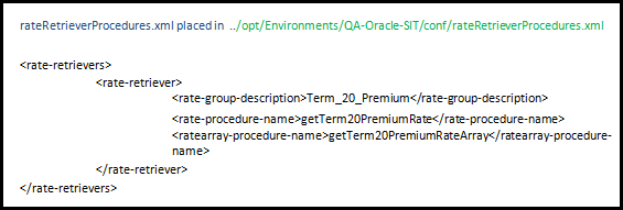

  2. Create an XML file. An example of the XML is provided at the bottom of this page and names the file rateRetrieverProcedures.xml.
  3. Modify or add the rateRetriever property in the System Properties document. In the example it should read as follows: #NamedStoredProceduresRateBll.config.filePath=/opt/Environments/QA-Oracle-SIT/conf/rateRetrieverProcedures.xml

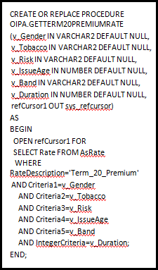

Rate
Rate Stored Procedure
Rate Stored Procedure Example

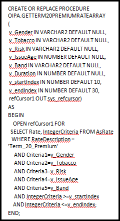

RateArray
Rate Array Stored Procedure Example
Rate Retriever XML Example
Rate Retriever XML
Rate Retriever XML
